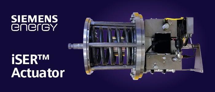

To help address these challenges, Siemens Energy developed the Omnivise iSER® Actuator (Intelligent Self-Contained Electrohydraulic Redundant Actuator). iSER actuators are designed to precisely control steam admission valves for power generation turbines and can be applied to other positioning, holding, and trip applications.
Omnivise iSER® Actuator’ Key Advantages:
  • iSER actuators are self-contained electrohydraulic turbine valve actuators designed for power generation.
  • The design eliminates the need for external electro-hydraulic (EH) skids and high-pressure hydraulic piping.
  • Built-in redundancy helps eliminate single-point vulnerabilities and supports reliable operation.
  • Digital controls and onboard sensors support condition monitoring and predictive maintenance.
  • iSER actuators integrate with modern plant systems using ethernet-based communications.

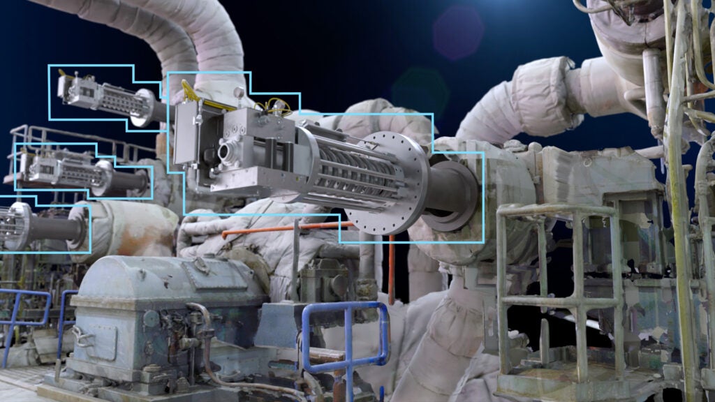

With iSER, the entire hydraulic system is integrated into the actuator. This removes several common sources of installation and maintenance complexity:
  • No external hydraulic power unit (HPU) required
  • No turbine-deck high-pressure piping runs
  • No large, hazardous oil inventory to manage
  • Fewer connections and leak points
Each actuator operates as a closed, self-contained system, dramatically simplifying design, installation, and long-term operation.

How the iSER Actuator Works: Intelligent Performance
The iSER actuator is a double-acting electrohydraulic actuator assembly. Motors and pumps generate hydraulic pressure on either side of the piston, allowing controlled valve movement. Once the actuator reaches the desired position, check valves maintain the pressure required to hold the piston in place, and the motors turn off.
For precise closed-loop control, iSER uses Linear Variable Differential Transformers (LVDTs) for position feedback. This supports:
  • Accurate positioning for modulating control
  • Stable holding at set-point
Additionally, LVDTs are available in duplex or triplex configurations. This closed-loop control enables near-infinite positioning resolution, making the iSER actuator well-suited for both modulating and non-modulating applications across a wide range of turbine sizes.
Built-In Redundancy for Mission-Critical Reliability
Reliability is paramount in power generation. A failure that prevents proper valve positioning—or prevents a valve from closing during a trip event—can create safety risk, and lead to unplanned downtime. The iSER actuator is designed with redundancy to reduce these risks. With the iSER actuator, if one motor or pump fails, the actuator continues to operate.
Standard redundant components can include:
  • Motors and pumps
  • LVDTs
  • Trip solenoids
These redundant pumps, motors, LVDTs, and trip solenoids help remove single-point vulnerabilities that can compromise turbine operation. In an emergency, the actuator includes a modular and online testable trip system. This smart design ensures both personnel safety and turbine protection, even under fault conditions.
