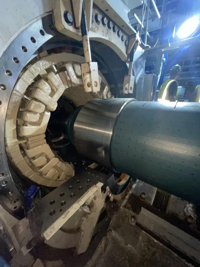

After removal of bearings, oil/hydrogen deflectors and seals, eyebrows were installed, end shields lowered and support brackets removed. Hydrogen coolers were removed and MD&A’s experts withdrew the field from the stator core.

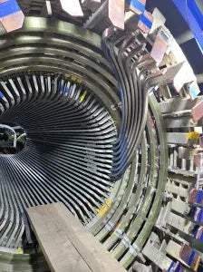

Stator bar installation then began.
All tie materials were saturated with air-dry epoxies for more-solid bonding, limiting any loosening post installation. All bar ties and phase blocking ties were made with epoxy saturated “8-strand” glass roving.
Previous side ripple spring (SRS) abrasion was a concern. MD&A generator engineering improved the SRS design to prevent abrasion issues that have led to premature failure in several similar units. This process was followed on each end of the bar for the top and bottom bars.
Following completion of bottom bar installation and electrical testing, inner radial rings were installed, and resistance temperature detectors (RTDs) were placed in slots. Top bar and side ripple spring installation was completed, followed by full electrical testing.

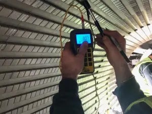

Each wedge was tested with an electronic hardness tester to ensure adequate TRS compression and to use as a baseline for future inspections.

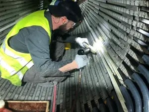

Series and phase brazing began. Brazing was performed with specialized double-headed torches for heating the plate/bar assembly. The phase and jumper connections were completed with the new plates manufactured by MD&A. Phase connection insulating series cap installation and all blocking completed the generator rewind work.
After completing all brazing work, copper winding resistance was measured to ensure that each of the three phases produced nearly identical resistance, indicating quality braze connections.

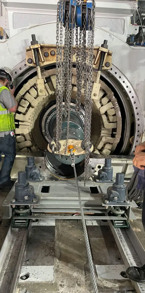

With hydrogen coolers and shields reinstalled, the field was prepared and inserted into the stator. Inner oil deflector clearances were reset to limit the ingestion of seal oil into the unit.
