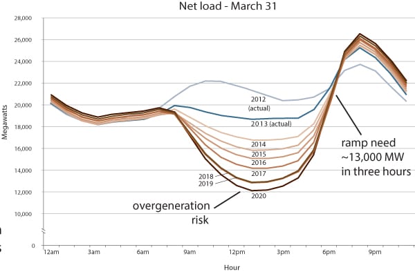

But one has to start somewhere, and that somewhere is California, where Tesla has already deployed several demonstration systems such as at the famed Kendall-Jackson winery in Napa Valley. California is also ground zero for the challenges of renewable integration, at least in the continental U.S. Again, you’ve probably seen this graphic from the California Independent System Operator (CAISO), which has come to be known as the “duck curve.”
1. If it quacks like a duck. This chart shows solar-induced ramping on a spring day in California between 2012 and 2020. Source: California Independent System Operator.
The curve represents the challenge of solar coming online in the middle of the day and then dropping off just as the evening peak demand starts ramping up. The shaded area is new solar capacity being added from 2013 to 2020.

In 2020, the area under the evening peak curve above 20 GW (about where it starts the day on the left) is roughly 22.5 GWh, unless my rusty calculus skills have failed me.
