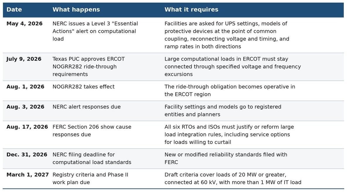

The Compliance Calendar
Which is where this is heading, faster than most of the industry realizes. NERC issued a Level 3 “Essential Actions” alert on computational load on May 4, 2026, with responses due Aug. 3, 2026. ERCOT’s Nodal Operating Guide Revision Request (NOGRR) 282 ride-through requirements were approved by the Texas Public Utility Commission (PUC) on July 9, 2026, and took effect Aug. 1, 2026. And on July 16, 2026, the Federal Energy Regulatory Commission (FERC) directed NERC to file new or modified reliability standards for computational loads by Dec. 31, 2026, with registry criteria and a Phase II work plan due March 1, 2027, as shown in Figure 1.
1. The computational load compliance calendar. Dates as filed or approved, with the ERCOT items applying only in Texas. Compiled by the author from NERC, ERCOT, and FERC filings. Courtesy: Shalin Savalia
The registry threshold is the number worth circulating. NERC’s draft criteria for a computational load entity currently cover an aggregate connected load of 20 MW or more at a single point of interconnection, at 60 kV or above, hosting 1 MW or more of computational load. That is not a hyperscale-only bar; it reaches well into colocation and enterprise sites whose operators are confident none of this applies to them. The alert also asks planners to collect facility UPS settings, models of the protective devices at the point of common coupling, reconnecting voltage and timing, and ramp rates in both directions. Those settings files are already on someone’s data request.

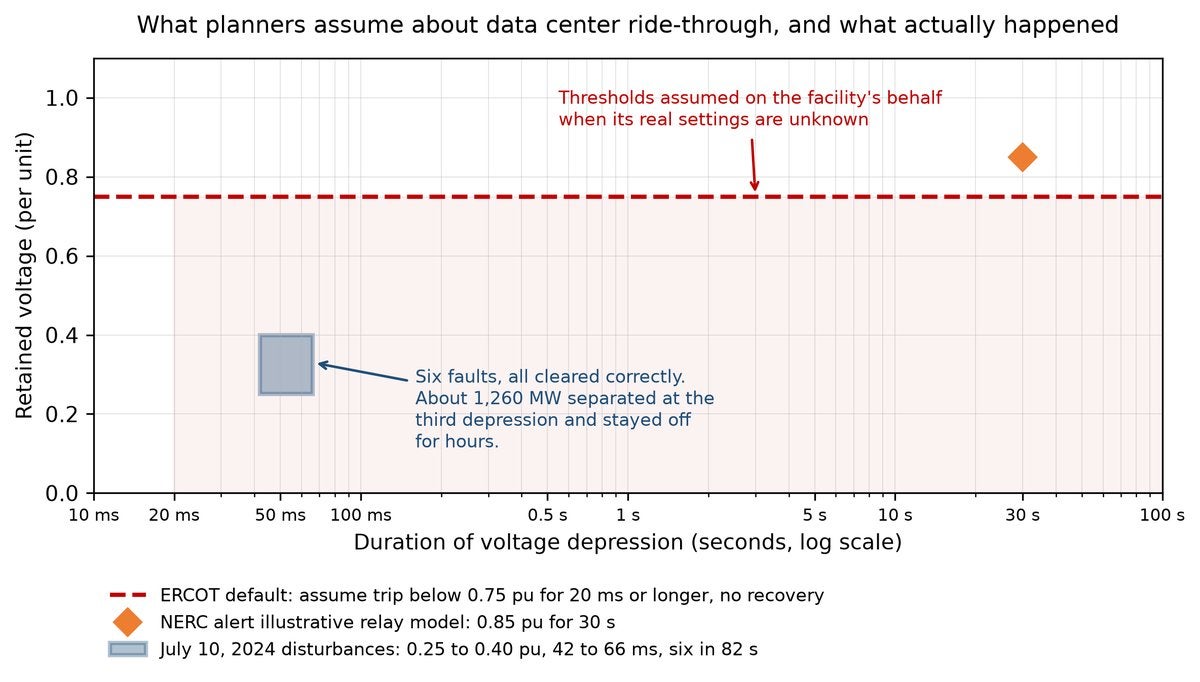

So, the question is not whether ride-through becomes a requirement. It is whether data centers write those settings or receive them, and the received version already exists. ERCOT’s large load stability studies white paper tells planners that where trip settings are in doubt, they should model those facilities as tripping below 0.75 per unit for 20 milliseconds or longer and not recovering for the rest of the simulation. NERC’s alert illustrates the same idea with a relay set at 0.85 per unit for 30 seconds. Those are the numbers assigned to the load in the absence of anything better, and they are penalizing by design. Both documents also say that a facility justifying its actual capability gets modeled as it truly is. That is the opportunity, and it is available now, without waiting for a standard, as shown in Figure 2.
2. What planners assume about data center ride-through, and what actually happened. The shaded band is the measured July 10, 2024, disturbance; the dashed line is ERCOT’s default trip assumption, and the marker is NERC’s illustrative relay setting. Sources: NERC incident review; NERC Level 3 alert, May 4, 2026; ERCOT large load stability studies white paper, Aug. 25, 2025. Courtesy: Shalin Savalia
