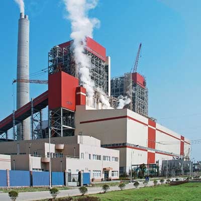

3.    China’s power plants. An August 2008 Massachusetts Institute of Technology survey of 85 Chinese power plants (a majority of which were coal-fired) found that the country’s air-pollution problems have less to do with the technologies employed and more to do with how the energy infrastructure is operated and the types of coals being burned. But China is making progress, the researchers found. Several new large-scale units have come on-line with higher steam conditions. An example is this coal plant in Waigaoqiao, near Shanghai, which uses a 980-MW Siemens steam turbine and has an efficiency of nearly 50%. Courtesy: Siemens
