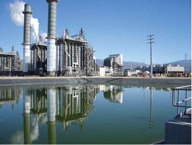

Southern California Edison’s (SCE) Mountainview Power Plant (Figure 1), about 80 miles east of Los Angeles, may not last 500 years like a phoenix, but it was resurrected after having been abandoned for two years. On the final day of 2005, three and a half months ahead of the original schedule, the second unit of the 1,054-MW plant was deemed "substantially complete"—a real feat, considering the number of hurdles thrown in front of the project team.
1. Lazarus project. Southern California Edison’s Mountainview Power Plant, about 80 miles east of Los Angeles, added 1,054 MW of much-needed capacity to the Inland Empire. Courtesy: Bechtel Power
