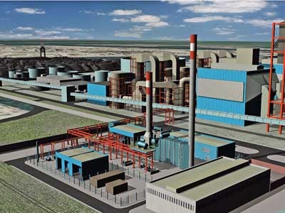

The €47 million plant is under construction at the site of Enel’s "Andrea Palladio" Fuina plant, a 960-MW coal-fired facility adjacent to the Porto Marghera petrochemical plant (Figure 4). Enel expects that when completely on-line in June 2010, it will produce 12 MW through the combustion of pure hydrogen — supplied as a by-product by the petrochemical plant — in a gas turbine with 43% efficiency.
4. Hydrogen power. An artist’s rendering shows a 12-MW hydrogen-fueled combined-cycle power plant that Italy’s Enel is planning to build at an existing coal-fired facility near Venice. The first industrial-scale project of its type, the plant will use a GE gas engine to combust pure hydrogen supplied by an adjacent petrochemical plant. The project is expected to be completely on-line by June 2010. Courtesy: Enel
Developed in association with General Electric, the gas turbine operates with a turbine inlet temperature of approximately 1,070C (1,958F) and is equipped with a newly developed combustion chamber. With the innovative approach used for fuel and air injection, the combustion of hydrogen significantly reduces NO x emissions compared with burning conventional fossil fuels, Enel says. The efficiency of the cycle is further increased by exploiting the exhaust gas to generate high-temperature steam, which will then be sent to the existing coal-fired plant, where it will produce an extra 4 MW of power.
